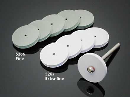

StewMac sells little wheel polishers for the Dremel that look very much like micromesh but domed to the dhape of the fret. they work geeat if you have a flex shaft.
